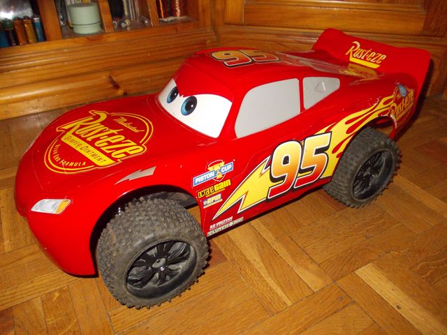

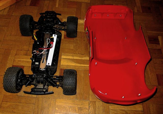

Do you remember the Mattel reference for your 1/12 McQueen car?
I have a project to mount the Mattel FBN52 toy body on a 1/10 truggy or 1/8 car.
The body has; length 50cm, width  25cm , wheelbase  29cm.
