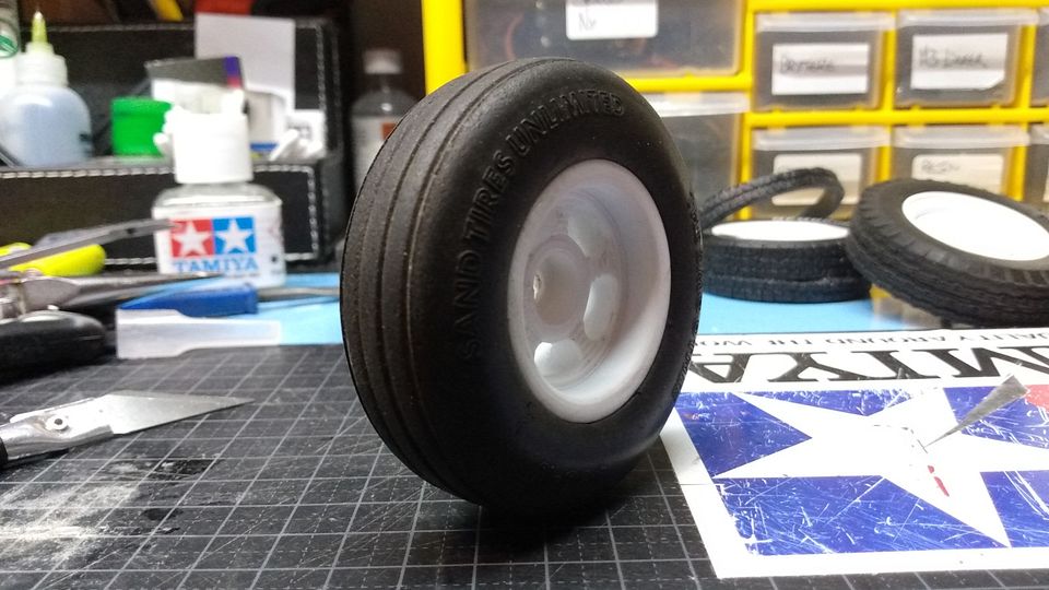

My parts so far:
Falcon battery strap
M chassis Fuchs wheels
VW hubcaps
Ansen Slot Mag wheel 1.7"
Knight Customs 1.7" VW wheel covers to go on FAV wheels
Ansen Slot Mag wheel 1.5" for Hornet tire
Latest has been a FAV front wheel center piece (no picture yet)
Most of my prints have been at FINE setting at 0,2mm layer, takes more time but better finish.
Lately I have printed a few on normal and fast setting just to try it out.
How much you fill your part is also something that that can take much longer time to print, 20 vs 100% infill etc.
