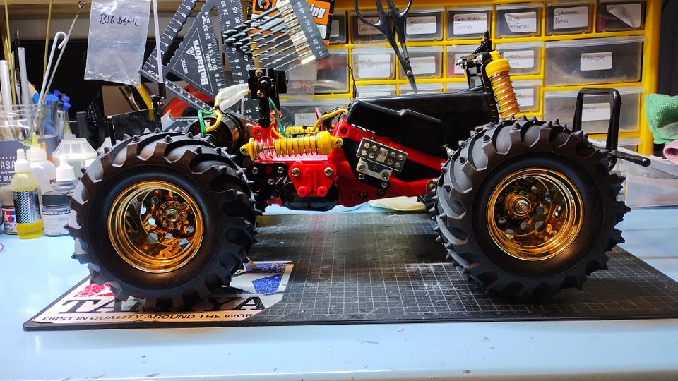

From my parts bin I've found some better wheels, with the gold mostly there.
Tires on these looked exactly like the old ones.
Gold vs the now chrome looking wheels. A bit difference!
The better looking wheels with new tires. Much better!
Did also the following today:
Fitted on/off switch
Soldered motor wires
Fitted better resistor cage.
Only needs receiver now to be driveable.
Drive axle boots needs fitting.
Shocks needs to be adjusted again.
Then there is the body...

Richard's vinttage Monster Beetle #1 rebuild. 4 months 4 weeks ago #77115
Yeah they look great. A bit strange I have not build/rebuilt one before. After all I do own 2x MB and Blackfoot.
Stange bit I had a rere Brat with the ABS body I got in a deal. But I never got the feeling for it. It might be the cream chassis, as I love the red on the Monster Trucks.
Today I fitted the red boots.
I did find my new Frog gear package, but no rubber in that..
Used AW grease in hope to make the driveshafts last a bit longer..
Was not happy with the shocks so I tore them apart.
Rear ones got 3 hole piston and soft oil. Only thing else I did was to fit a spacer on the inside to make arms not drop all the way when in the air. Those who know ORV chassis know it makes a horrid noice while the wheels gets off the ground while driving.
Front was a bit saga.
3 hole piston and lube the seals real good did notthing to make the shafts to slide as they should.
Even rebuilt it 2 times and still no good.
After some further investigation, the still chrome looking shafts seems to have a like sanded finish, while still looking as shiny chrome.
A bit later I found some used shocks in the parts bin, pulled the shaft from that and fitted the two hole piston with slightly bigger holes than that used to be there.
The last rebuild I used all new plastic parts, not it's basicly a new shock with a second hand piston rod.
Still too stiff for me, so next step is to fit 3 hole piston here as well.
Despite rebuilding these shocks several times, I still prefer to rebuild shocks vs any bodywork or body painting.
My still growing clear bodies under the desk is a proof of that lol.
Add winter 6 months a year, and bodywork keep getting behind the list evey year lol.
