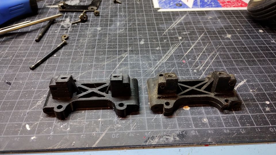

Yesterday I 3d printed the front bulkhead which is the main cause this project has been sleeping in a box..
This is the part in question...
Getting somewhere...
The new part seems correct where it counts
Yes it fitted without any trouble at all!
Only had to sand down the hing pin are slightly so the arms would slip on. Rather have it too tight than lots of slope.

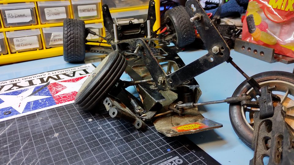

Also made some struts for now to replace shocks as I have nothing that will fit this
And how it sits now
