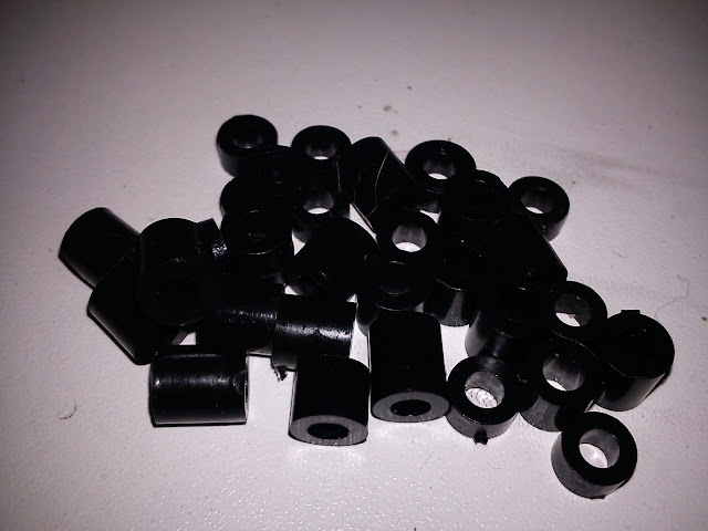

a little hint, D15. :whistle: (guess whoever did the DB used them in the rear too ;) )
Vintage Manta Ray customisation quest 12 years 6 months ago #4948
those look like plastic meccano spacers
Vintage Manta Ray customisation quest 12 years 6 months ago #4951
  • Edou
  • Edou's Avatar Topic Author
  • Hopping Mad
  • Hopping Mad
  • Posts: 6135
  • Likes received: 483
I think Waterbok has the heart of the matter there. :)
The clue is in the spacers. A very generic looking part (like zephyrin mentioned) that makes a lot of difference.
Looks like they're made out of metal in the 50305 picture...
Still - going over that low res pic, I only see one pair of spacers there. :huh:
Which would lead two only two possible lengths.
Makes me wonder how long that damper shaft is...
Edit (maybe Eureka!) : I see a second pair of shafts already inside the shocks on the picture... :cheer:
Quite sure now it comes with two sets that are 10mm different in length.
