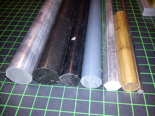

got some stuff delivered today :cheer:
diy belt
Needs some practice to get it right but the weld that finally hold was quite strong.
