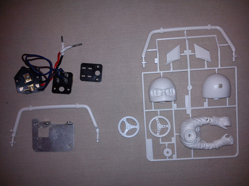

I need some parts for a forthcoming Willy's Wheeler project ... some of these are shared AFAIK with the Wild Willy so may be findable with patience, others are going to be a lot more difficult or rediculously expensive, so I'd be grateful if anyone could give me information on dimensions/post pics so I can make my own :)
First off, the difficult bits:
T2 - bumper holder
I'm hoping to make my own, jsut without all the wibbly bits so need dimensions for this...
A7 - rear roll loop/chassis body mount
Again, I'll probably try & make something functionally equivalent, so need dimensions/angles...
B2 - headlamp lenses
IIRC these were lightly tinted, sloped and concave - an extreme closeup photo would really help
A1 - steering wheel
Less problematic, can any one confirm or refute that it's the same as the Wild Willy or modern stupid wheelie bus one?

On to the "easier" bits:
"Switch Stay" (servo mount plate)
I know eddrick made one of these, but it's beyond my ability ... if anyone has one that would be great (I can look at eBay as well as the next man ;) )
"Resistor Plate"
Again, shared with the M38 AFAIK - but mine's smashed to badword to a pic or part would be a big help ...
K8 (steering servo horn widget)
I think I'd just make a replacement for this - can anyone confirm/improve upon my guesswork dimensions? M2 thread, 3mm OD, 4mm long?
I would also appreciate any info on bearing sizes (the gearbox ones) too.

I have a wheeler lying around in bits and pieces so I could give you an answer tonight on most of the parts. I might have a spare servo mount and resistor plate too.
k8 measurments should be correct but can check on those. (i could use a couple of those btw.)
And I got this :woohoo: you are not the first to replicate that one.
got one missing lamplens on my second wheeler and am looking for replacment no luck sofar with Tamiya parts (lunchbox, bruiser, srb all different size)
I got an leftover A7 so that could go with the servo and res.plate.
do you have the driver otherwise get the one from the new jimny/VW T2 its on the sprue
cant find it :cry: :cry:
A1 - steering wheel
yes is the same as from wheelie bus and the Jimny, the sprue also comes with the rear roll loop (without the metal insert :-( ) They other steeringwheel is from the M38

T2 - bumper holder
"Resistor Plate"
got them both
outs.dia. 3mm, length 3mm, and M2 tapped
some standard 1150, the flanged ID5, OD8 Height4 and flange OD 10 and T1, and the small ones ID3 OD7 H3
